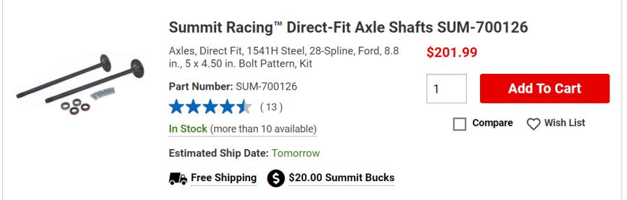

So, early this year I got a little heavy on the skinny pedal and the rear end kicked out and hit a curb. Tore up the tire and wheel. Replaced those and thought all was good. Then at the spring meet, one of the guys following me said the rear wheel looked loose or had a wobble. Now I'm thinking of replacing the axle. A couple of questions for the group. I'm fairly mechanical minded but have never done an axle replacement.
1) Is it difficult to replace? Bent axle is on the drivers side.
2) Should I do both sides if doing one side? Car only has 550 miles on it.
3) Summit Racing looks like they have replacement axel's https://www.summitracing.com/search...dMatch&SortOrder=Ascending&keyword=sum-700126
4) Are these the correct replacement axels?
5) Is there anything else I need? I have quick jacks to get it off the ground to do the work.

Kinda late to this party. I just got around to registering. Rob you need to know what width your axle housing is or what it came out of. I assume it's an 8.8 Ford, Since that's the link you posted to Summit. Most likely Fox body Mustang, but they came with 4 lug axles so it must have aftermarket axles. Later Mustangs came with 5 lugs but are wider, so different axles. They could be 28 or 31 spline count depending on what carrier is in your car.
