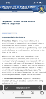

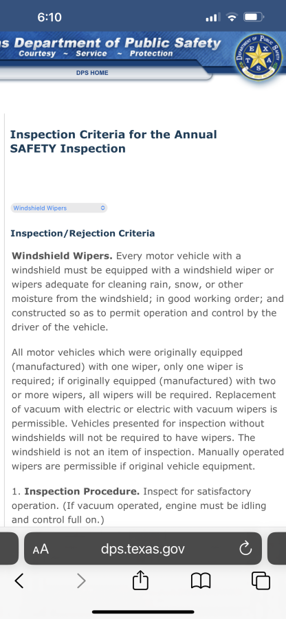

I was having trouble getting my wipers to work properly, and I wanted to get my car inspected and registered NOW, not when I figured out the problem. So I looked over the DPS inspection criteria and found that if you present a vehicle for inspection without a windshield, wiper inspection is moot. A windshield is not required as part of the safety inspection process. Only the wiper, if you have a windshield. So I took five minutes to remove my windshield, got it inspected, and took another five to reinstall it. I also have my rear view mirror dash mounted. Only one rear view mirror is required for inspection. As the old adage goes, there is always more than one way to skin a cat.
